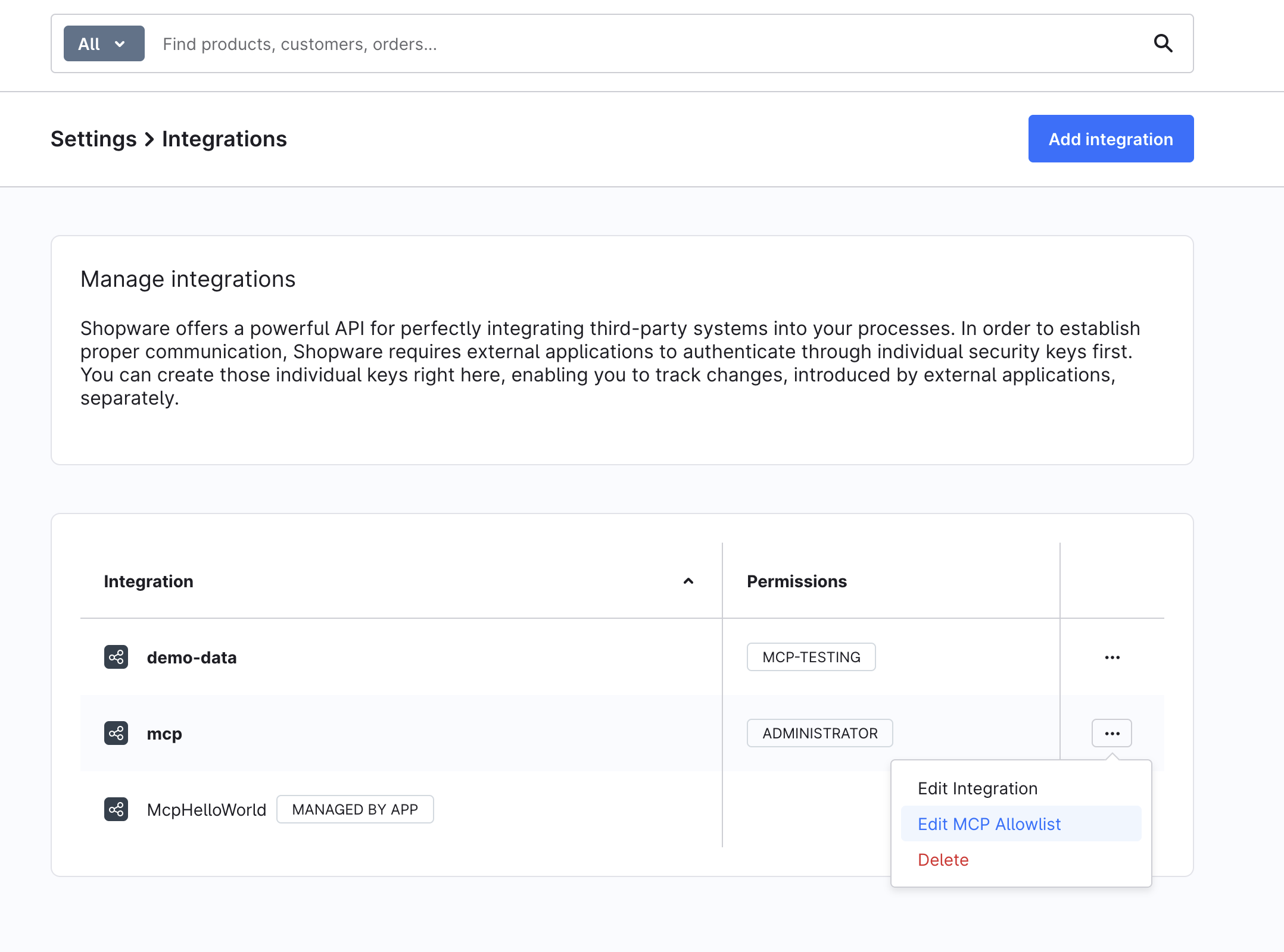

Per integration — Go to Settings → Integrations, open the context menu for your integration, and select Edit MCP Allowlist:

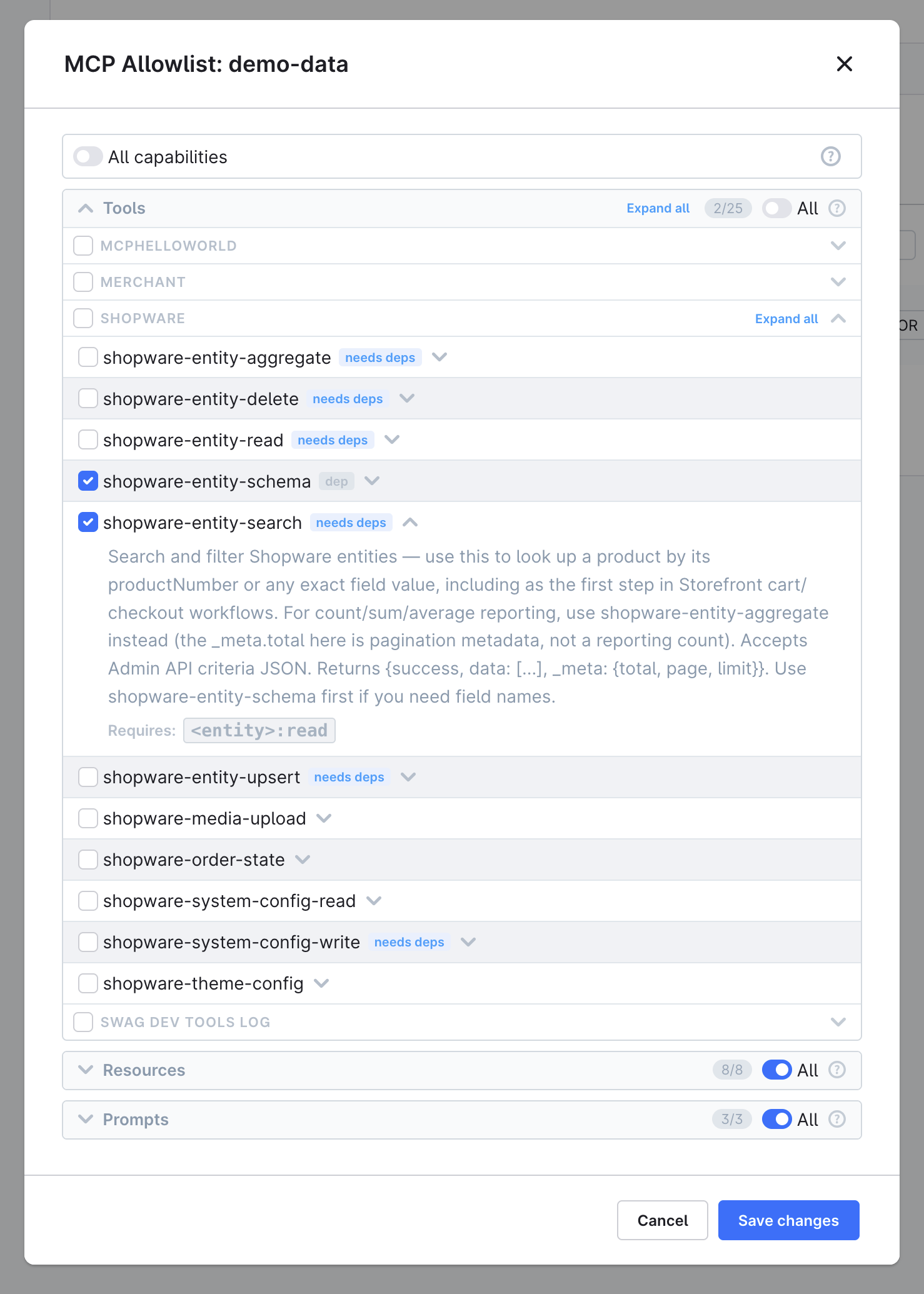

Disable the toggle for each capability type and select only the tools, resources, and prompts this integration should use:
Per user — Go to Settings → Users & Permissions, open the user detail page, and manage the MCP Tool Allowlist card at the bottom of the page. This allowlist applies when the user authenticates via a user access key or bearer token. Admin users bypass the allowlist entirely.
When a tool is enabled, its declared dependencies are automatically included. For example, enabling shopware-entity-delete also enables shopware-entity-search and shopware-entity-schema because they are required for it to work.
